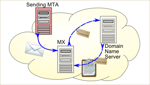

SPF Records
An SPF record is a Sender Policy Framework record. It’s used to indicate to mail exchanges (servers) which hosts are authorized to send mail for a domain. These records are defined using the TXT record type. There’s also an SPF record type, but it’s no longer used.
By Ale2006-from-en - Own work, CC BY-SA 3.0, https://commons.wikimedia.org/w/index.php?curid=24650591
We have a separate guide - How to Create an SPF Record in cPanel - which goes into detail on how to create SPF records and configure them in your DNS.

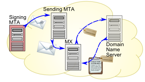

DKIM
DKIM (DomainKeys Identified Mail) is an email security standard designed to make sure messages aren’t altered in transit between the sending and recipient servers. It uses public-key cryptography to sign email with a private key as it leaves a sending server. Recipient servers then use a public key published to a domain’s DNS to verify the source of the message, and that the body of the message hasn’t changed during transit. Once the signature is verified with the public key by the recipient server, the message passes DKIM and is considered authentic.
While DKIM isn't required, having emails that are signed with DKIM appear more legitimate to your recipients and are less likely to go to Junk or Spam folders. Spoofing email from trusted domains is a popular technique for malicious spam and phishing campaigns, and DKIM makes it harder to spoof email from domains that use it.
DKIM uses two actions to verify your messages. The first action takes place on a server sending DKIM signed emails, while the second happens on a recipient server checking DKIM signatures on incoming messages. The entire process is made possible by a private/public key pair. Your private key is kept secret and safe, either on your own server or with your ESP, and the public key is added to the DNS records for your domain to broadcast it to the world to help verify your messages. Let’s dive a little deeper into how DKIM works on servers that are sending and receiving email.
By Ale2006-from-en - Own work, CC BY-SA 3.0, https://commons.wikimedia.org/w/index.php?curid=24673045
DKIM can be generated and installed under the Email Deliverability section in cPanel. It's important to note that to correctly install a DKIM record, your server must be the authoritative nameserver.
