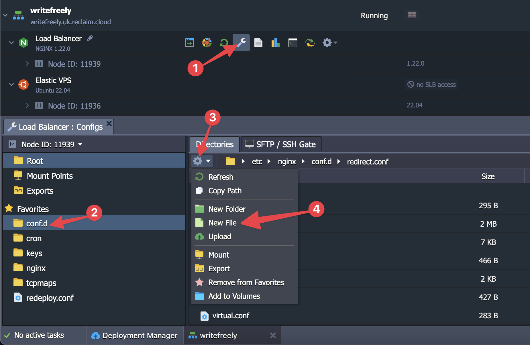

We'll need to make a redirect.conf file in the /etc/nginx/conf.d folder of our nginx load balancer. To get started, click the config button for the Load Balancer, then click on the conf.d folder. Next, click the cog button > New File:

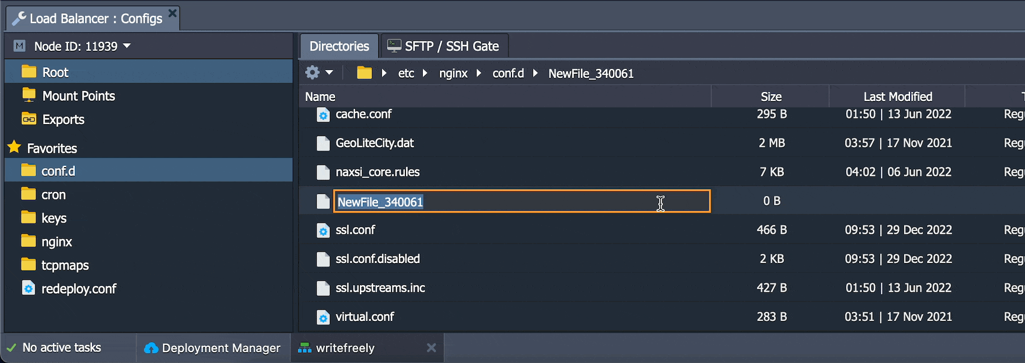

Name the file redirect.conf and press enter to confirm. Note that the file can technically be named anything, as long as it ends in .conf.

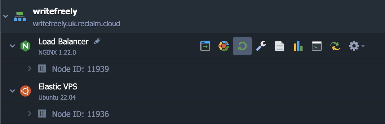

Finally, click the Restart Node button next to your Load Balancer node!
