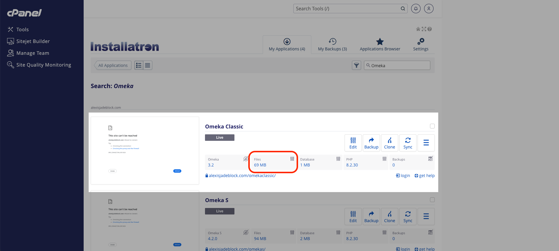

To begin, you'll need to first navigate to the File Manager and locate your files for your application. You can easily access the correct directory by logging into your cPanel and locating the application by clicking My Apps located in the Applications section of your cPanel.
Then, you'll locate the application you're wanting to update and select Files under that application:
cPanel My Apps interface showcasing an Omeka Classic installation card with the Files button highlighted to open its root directory

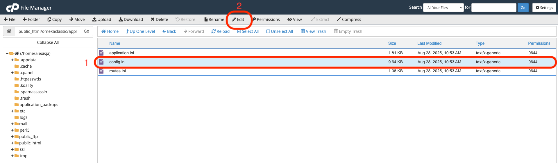

Once in the File Manager in the correct directory, you'll locate your  config.ini   file. This is located in the application > config folders in your Install.
For our example, my site is located at alexisjadeblock.com/omekaclassic, and my config.ini file is located at the following path:  public_html/omekaclassic/application/config/config.ini
After you've located the file, select the config.ini file so that it's highlighted and then click Edit from the top menu bar of the File Manager.
cPanel File Manager navigation showing the application config folder with config.ini selected and the top Edit button highlighted

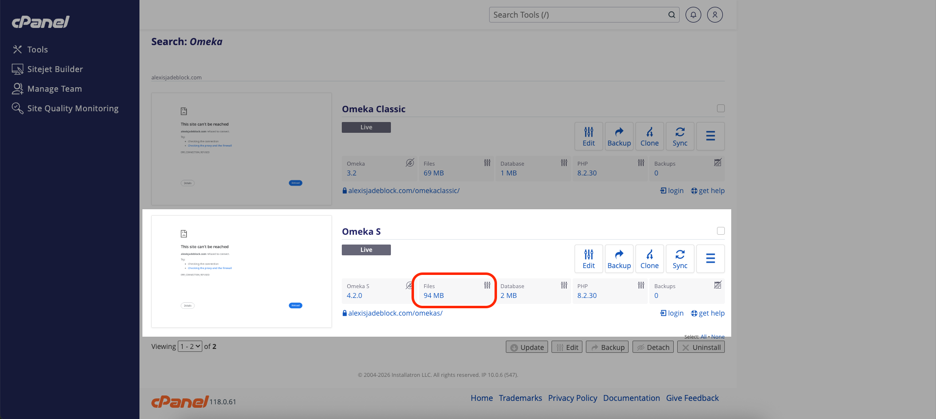

First, you'll need to first navigate to the File Manager and locate your files for your application. You can easily access the correct directory by logging into your cPanel and locating the application by clicking My Apps located in the Applications section of your cPanel.
cPanel My Apps dashboard displaying an Omeka S installation card with its active Files button highlighted

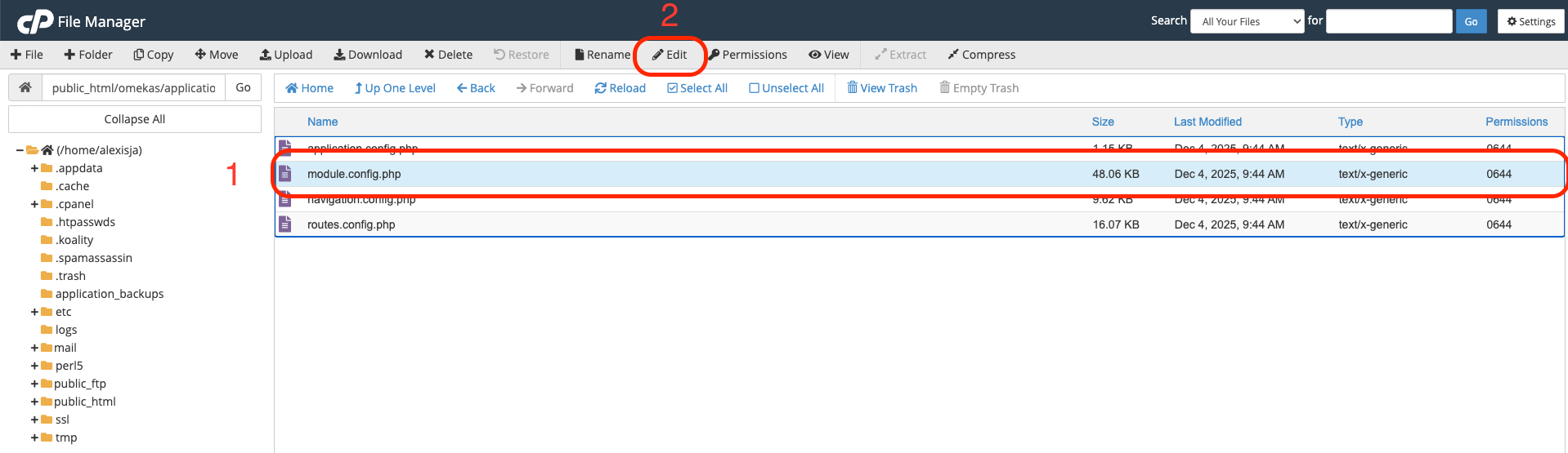

Once in the File Manager in the correct directory, you'll locate your  module.config.ini   file. This is located in the application > config folders in your Install.
For our example, my site is located at alexisjadeblock.com/omekaclassic, and my config.ini file is located at the following path:  public_html/omekas/application/config/module.config.ini
After you've located the file, you will select the module.config.ini file so that it's highlighted and then click Edit from the top menu bar of the File Manager.
File list inside the Omeka S config folder highlighting the selected module.config.ini file and cPanel File Manager's top Edit button
