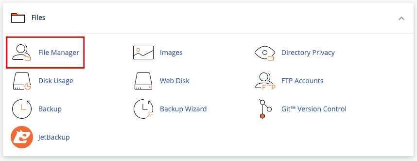

Use the File Manager to navigate Omeka's install directory
Editing files can be done from within cPanel by using the File Manager:
Locating the File Manager icon within the Files block layout of the main cPanel dashboard interface
Navigate to the folder where Omeka Classic or Omeka S is installed, which is likely public_html or the name of the domain or subdomain your site is installed to (ex: omeka.mycooldomain.com).
