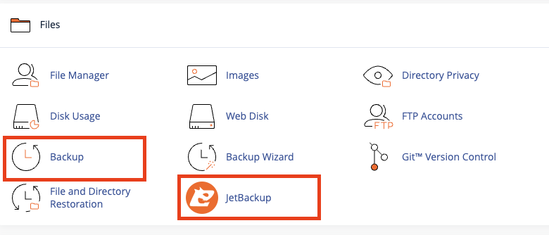

Taking a Backup
Because you're working directly within the file system for the application you will want to make sure to get a backup of the site before you begin work. This way you can restore the backup of the site with ease knowing the site was working prior to the updates.
cPanel's Files section with the Backup and Jetbackup options highlighted.
There are several ways to work through getting a backup on your site, you can choose which option works best for you:

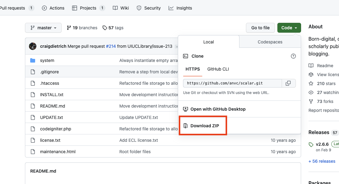

Next, you'll want to download the files for the particular version of the application you're working through. You can download directly from the developer's website (like WordPress.org or Omeka.org) or use a GitHub repository.
You will want to download the files in a .zip format to do some additional configuration prior to uploading. Github repo with the Code options expanded showing the Download link for the Scalar ZIP file.

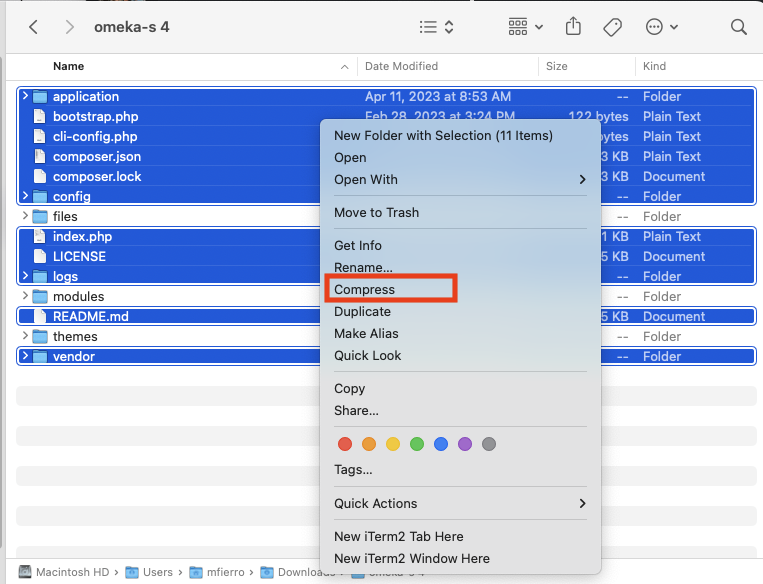

When working with the manual update, you will want to take into account any content changes you or the user made prior to the update. This way you can save any media, posts, pages, collections, books, etc from becoming overwritten. Within each application, you will want to consider excluding the following files/folders from the update:
  • Plugins/Modules
  • Themes
  • Files/Uploads (media)
  • Configuration files (like database files or local settings)
To accomplish this, you can simply exclude the files from the compression or make local copies of the files/folders to add back once you've completed the update. This can be different depending on the application, so be sure to check where these files/folders are stored within the file system.
Once you've made your selection, compress it into a .zip file. This will be helpful when uploading the files to the File Manager.

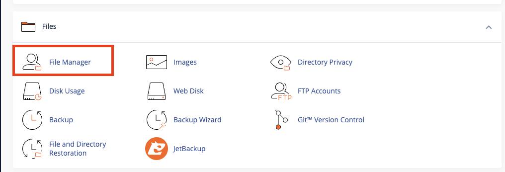

To access the file manager, first log into cPanel. Then click File Manager.
cPanel dashboard view highlighting the File Manager icon within the Files section layout.

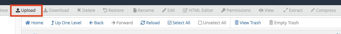

Navigate to the location you're working with and click Upload on the tool bar at the top of your screen.
cPanel File Manager directory view highlighting the Upload option in the top toolbar menu.

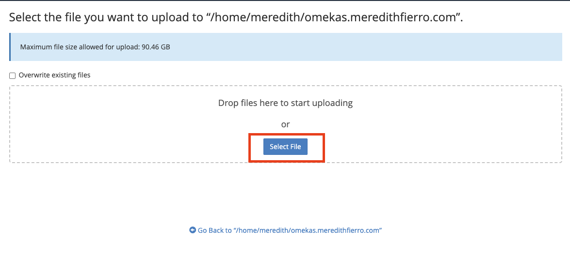

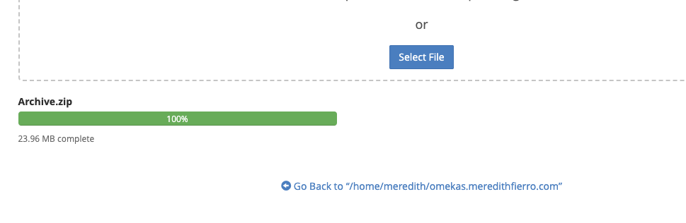

Next, you'll be asked to select the file to upload. Select the .zip you're working with and click/drag to upload or follow the prompts on the screen.
Note: You cannot upload individual files/folders using this method. cPanel only allows for single file uploads through the File Manager. The .zip archive is a workaround.
The cPanel File Upload page with the Select File button highlighted.
Once uploaded, you will see green success bar, signaling the upload is complete. Click the "Go Back" to bring you back to the

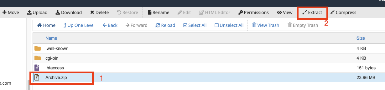

cPanel File Manager main view focusing on the Extract option in the toolbar after selecting the newly uploaded ZIP file archive.
You should see the .zip file you just uploaded, if not use the Refresh button. Now you're going to Extract the .zip. Select the .zip and click Extract in the top toolbar.

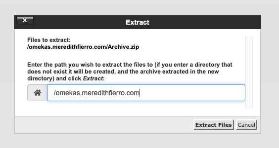

Screenshot
Click to confirm the location where the files/folders will be extracted. This will move the files/folders into the directory you were working with, and replace any File/Folder that has been changed to the version uploaded.
The Extract confirmation dialog pop-up box prompting the user to enter or verify the target directory path for the unzipped application files.
