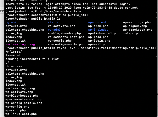

As an example, I decided to move WordPress files from a test WordPress site on another server to one of my accounts. I logged into the server, then changed directory to the WordPress site in public_html. Then I ran the command:

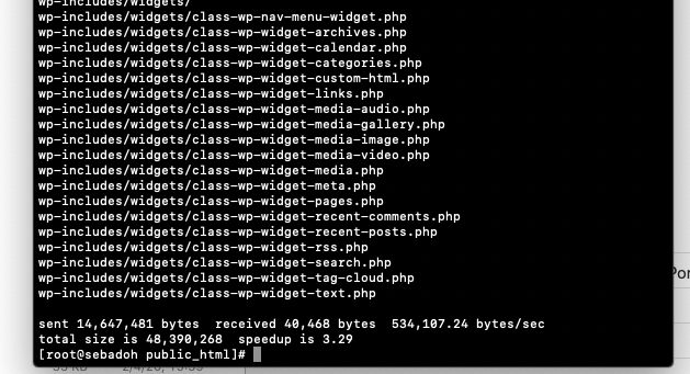

From there, I got an output and running list of all processes to my account:

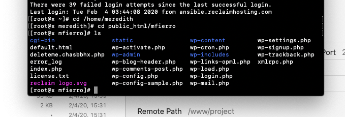

Once that’s done, you’ll see all the files in the new location!
