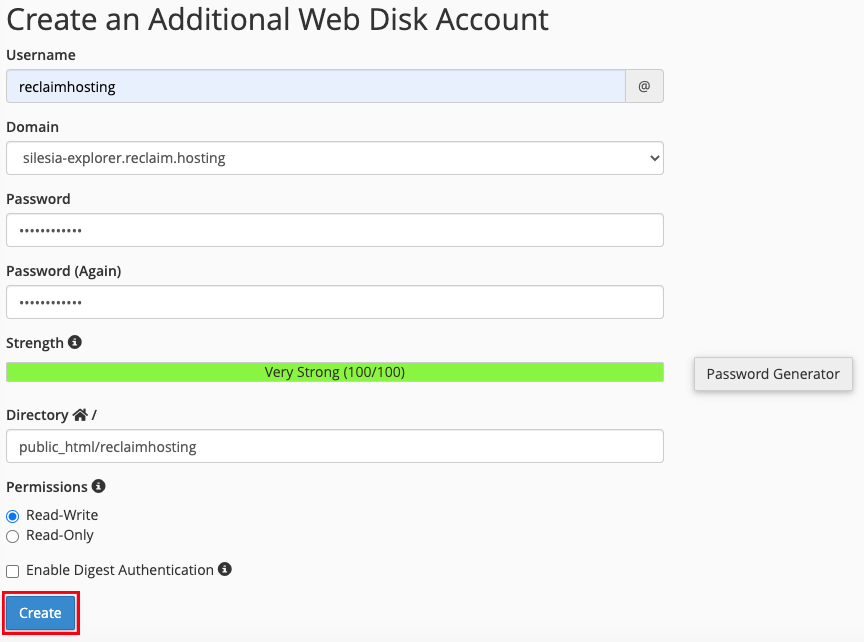

3) Create a Web Disk account.
To configure a new Web Disk account, you'll need to enter a Username, select the Domain, provide a Password, Directory (if this is created under public_html please be aware that any uploaded files will be publicly accessible), and finally set the Permissions. Once the desired values have been entered, click the Create button. You'll receive a message letting you know that the Web Disk account has been successfully created.
