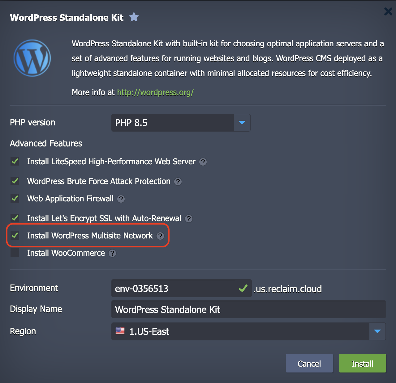

To change your WordPress Multisite domain, you'll first login to https://app.my.reclaim.cloud/ and install Wordpress if you haven't already. We have instructions on how to install WordPress on Reclaim Cloud, but you'll want to make sure that the box next to "Install WordPress Multisite Network" is checked when installing the application.Screenshot 2026-05-25 at 2.34.16 PM.png

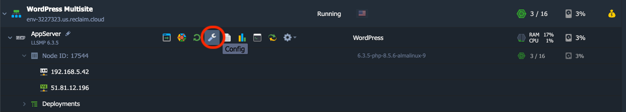

After your domain is pointed to the correct IP, you'll then want to change the domain inside of your wp-config.php file. To open and locate your wp-config.php file, you can hover over the AppServer and select the wrench icon to view the Config panel of your application.
Your wp-config.php file is most likely located at the following path: /var/www/webroot/ROOT/wp-config.php, which you can quickly locate by clicking the favorited webroot folder in the Config sidebar, opening the ROOT folder and then selecting the wp-config.php file.

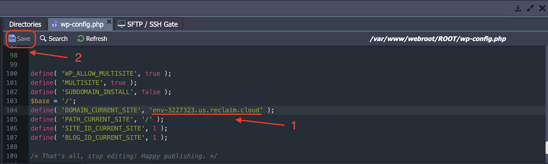

Once the wp-config.php file is open, you can then locate where DOMAIN_CURRENT_SITE is defined in your file. For most setups, this can be located on line 104, but you can easily do a Ctrl+F command to locate that variable.
Once you've located where your DOMAIN_CURRENT_SITE is defined, you can update your domain from your automatically generated env domain to your new apex domain by replacing what is inside the single quotation marks. Once that domain is updated, click save to ensure that the changes take effect.
Here is an example if I was adjusting my domain from env-3227323.us.reclaim.cloud to example.com:
define( 'DOMAIN_CURRENT_SITE', 'example.com');

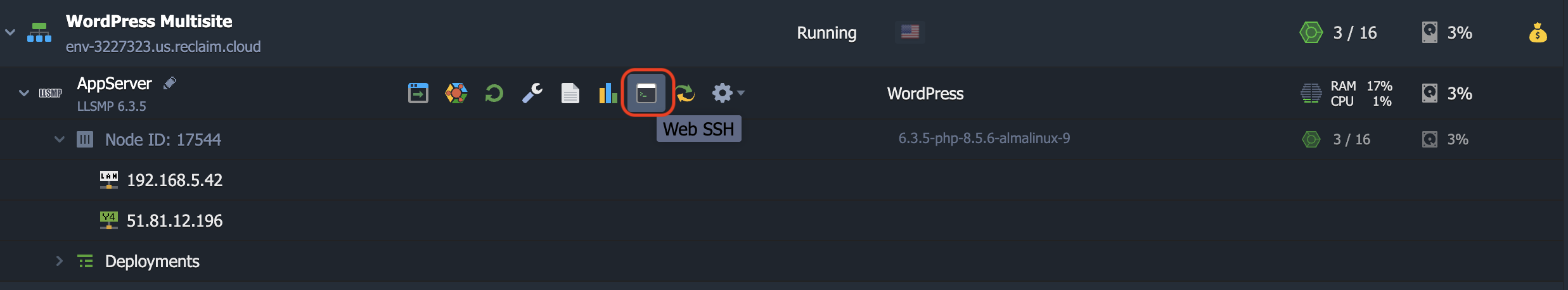

After your wp-config.php file is updated, you'll also need to complete a database search and replace in the terminal. To open your terminal, you can once again hover over the AppServer and click the terminal icon to open the WebSSH window.
