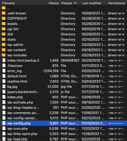

Using FileZilla, connect to your account via FTP-SSL. Once connected, navigate to the files or directories for which you would like to change the permissions.
Since we want our files to have a specific set of permissions and our directories to have a separate set of permissions, we'll need to take an additional step here to help FileZilla make that distinction.

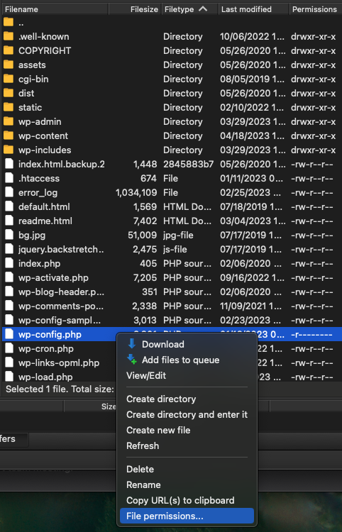

Right-click on the name of the file you want to change the permissions for and click on File Permissions.

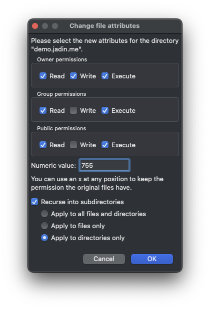

Right-click on the name of the directory you want to change the permissions for and click on File Permissions.
A new window will pop-up. In it, use the checkboxes to set the desired permissions or alternatively use the Numeric value text box and input the numeric value of the desired permissions. For directories, we'll want to select the 755 permissions value so that the directory owner can Read, Write, and Execute, while the group and public roles can Read and Execute.
If you want to apply the same permissions for all directories inside the current directory, enable the Recurse into subdirectories option. Once ready, click OK.

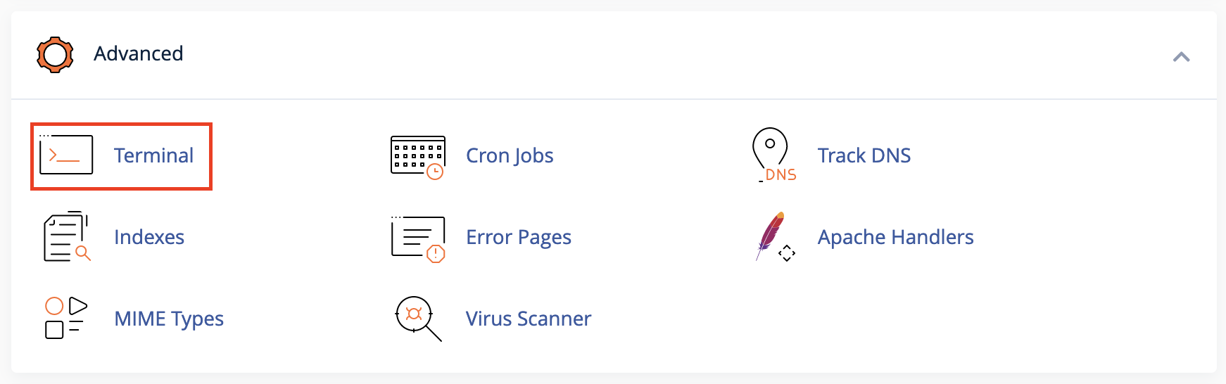

To do this, you'll first need to go to your Terminal under the Advanced section of your cPanel dashboard.

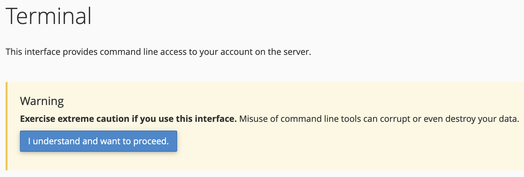

Then, you may see a Warning screen, which you can move past by clicking I understand and want to proceed. As long as you follow these instructions carefully, your account will be fine.

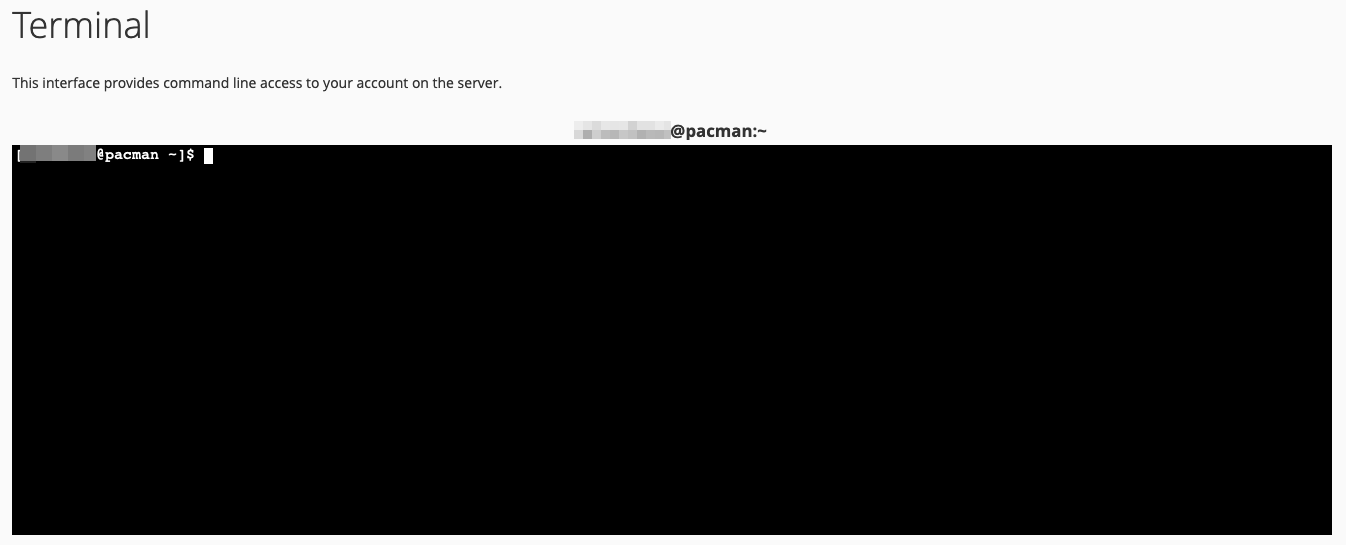

Once you choose to proceed, you'll see a screen like the one below.
Here, you'll see your cPanel username followed by "@servername". In this instance, this account is on the pacman server.
