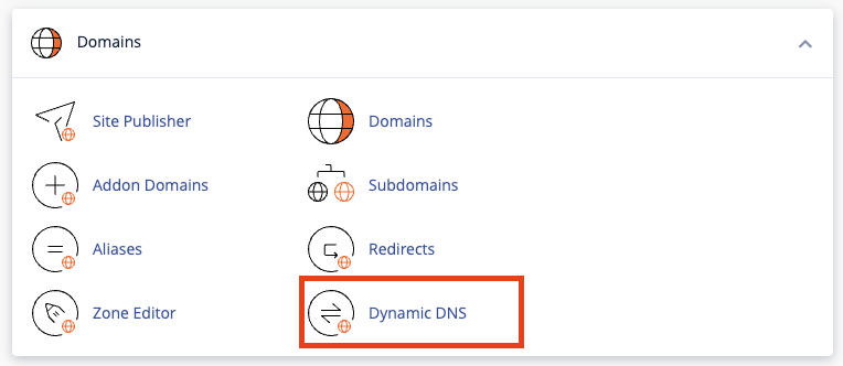

Configuring DDNS On cPanel’s Side
To create a DDN entry, hit Dynamic DNS under Domains in your cPanel account.
From here, click Create on the right side to create a DDNS entry.
