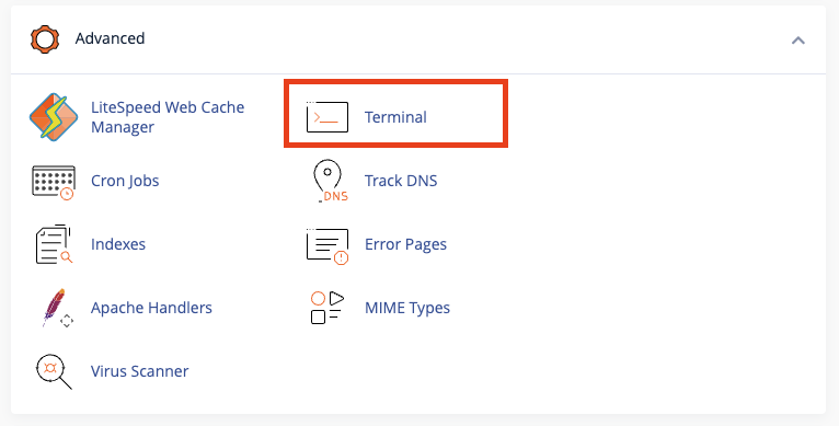

1. Log into your cPanel account and look for Terminal under ADVANCED.
If this is your first time accessing Terminal you’ll receive a warning message and need to click the blue I understand and want to proceed button.
You will now see a black screen which is the interface for the Terminal. The part before the @ symbol is your cPanel username. The part after the @ symbol is the name of the server your hosting account is installed on.
