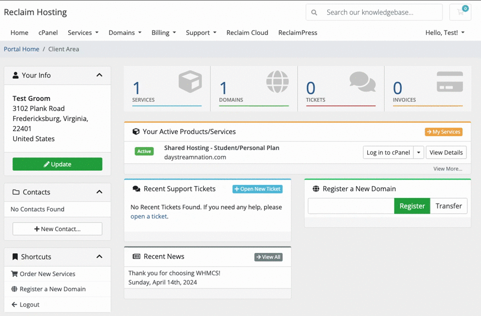

  1. Log in to your Client Area
  2. Go to Domains > My Domains
  3. For the domain you wish to unlock click Manage Domain
  4. From this domain management interface you will find a tab called Registrar Lock that will show you the current status and allow you to toggle the lock on or off.
