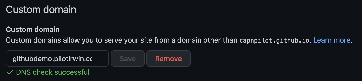

  4. Under "Custom domain", type your custom domain, then click Save. If you are publishing your site from a branch, this will create a commit that adds a CNAME file to the root of your source branch. If you are publishing your site with a custom GitHub Actions workflow , no CNAME file is created. For more information about your publishing source, see "Configuring a publishing source for your GitHub Pages site."
You'll know you're ready to go when the DNS check for your custom domain comes back successful.
This screenshot uses a subdomain as an example, but the settings are controlled in the same place and the DNS check will work the same way.

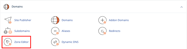

Once you've completed the starting configuration steps in GitHub, which will be through step 4, you'll need to find the DNS Zone Editor under the Domains section in cPanel.

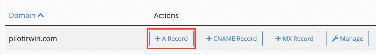

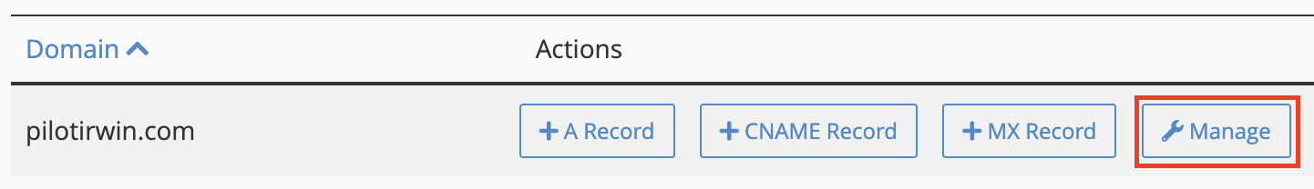

After that you need to choose the root domain you will be mapping, and locate the tools for managing its A Records.
If A Records already exist for this domain, which you can check using the "Manage" tool, you may need to delete them in order to prevent conflicts. We recommend always taking a screenshot or otherwise recording the contents of any records before you delete them, in case you need to undo your work for any reason.

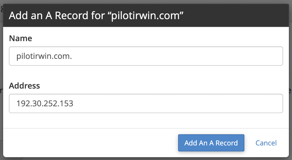

Once you select the domain, you need to create two A Records for it using the below screenshot as a template. The Name field will hold the domain you are trying to map, and the Address field will hold the IP you want to map the domain to. GitHub has two separate IP addresses you'll need to map the domain to, 192.30.252.153 and 192.30.252.154, so you will need to create a separate A Record for each one.
Once you have created both A Records in the DNS Zone Editor you should be all set.

Like above, you will complete steps 1-4 in the settings for your GitHub Pages site's repository. You'll know you're ready to go when the DNS check for your custom domain comes back successful.
After you've completed the starting configuration steps in GitHub, go to the DNS Zone Editor in the Domains section of cPanel.
Note: In the above screenshot, you will see that the Domains section in cPanel also includes a tool called Subdomains. This tool is useful if you want to set up a site in a subdomain that is hosted on your cPanel. It will generate a subdomain with a full set of pre-existing records, including A Records that point the subdomain towards your cPanel. These A Records will cause conflict with the CNAME record you are trying to set up, so if you want to generate a subdomain that you intend to point elsewhere with a CNAME, you shouldn't use the Subdomain tool.

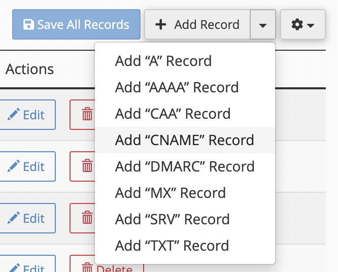

Once you've reached the Zone Editor, select Manage. This will take you to a place where you can manage all existing records, as well as create new ones.

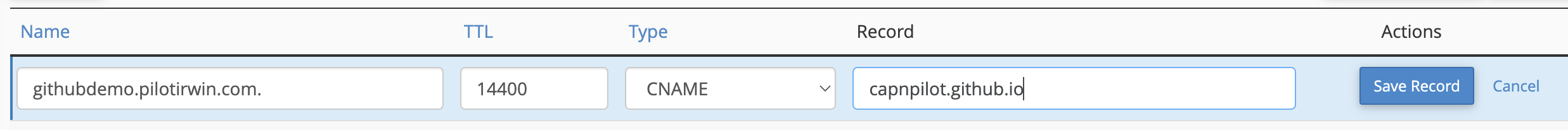

Find the tool marked Add Record, then select Add "CNAME" Record.
Then you can create a new subdomain that only uses a CNAME record, and point it to the place it needs to go. Put the name of the subdomain in the Name field, and the URL of your GitHub account in the Record field, then save the record.
After that you should be set. Even if your repository is located at capnpilot.github.io/tempdemo, like the one in this example, you only need capnpilot.github.io in the CNAME field. This is because when you originally set the domain settings in GitHub, you did this in the settings for the repository that's located in the subdirectory (here, that would be the settings for capnpilot.github.io/tempdemo).

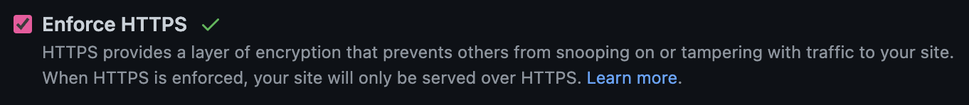

Forcing HTTPS
You can force HTTPS on your site by navigating to your site's repository, then going to Settings > Code and automation > Pages > GitHub Pages. In the GitHub Pages section, you'll be able to select Enforce HTTPS.
GitHub also has documentation for this available in their guide, "Securing your GitHub Pages site with HTTPS: Enforcing HTTPS for your GitHub Pages site."
