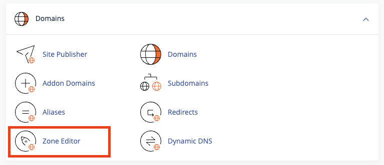

When working with the cPanel Zone Editor, the TTL can be changed. Below are the steps you can follow in order to modify the TTL value for your domain.
Navigate to your cPanel’s Zone Editor -
