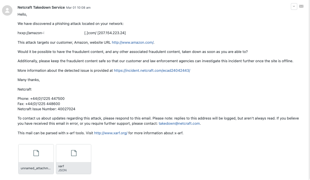

Right now, Reclaim mainly receives two types of takedown requests: phishing content or DMCA copyright reports. These requests come typically come from DigitalOcean or Netcraft.  The report typically looks like this:
You'll see a URL that points to the location of the report, what content is copyrighted/compromised, and a link to the full incident. Be sure to read through the full report link for any back history.

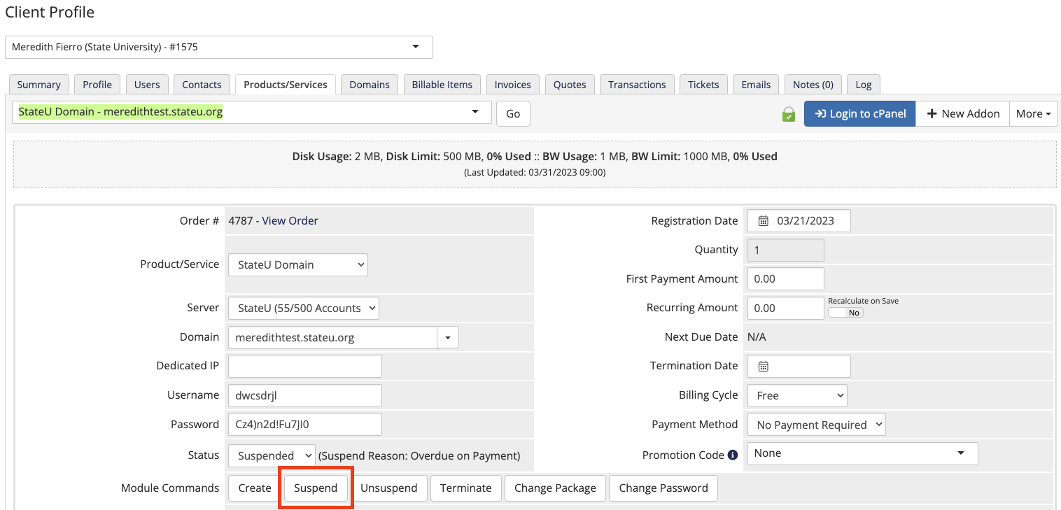

2) Suspend Account in WHMCS

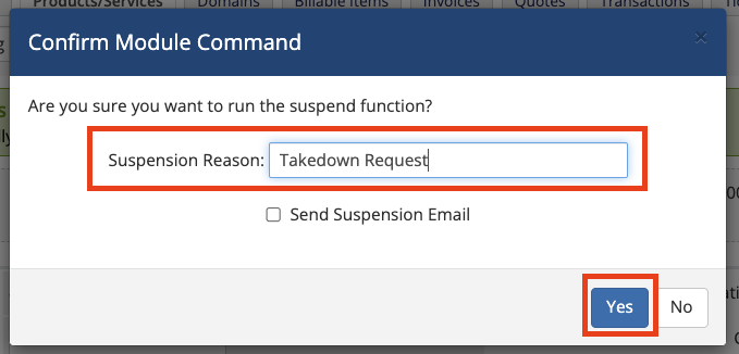

If you need more time to work on the account to remove the content, you can suspend the account directly from WHMCS.
You'll be prompted to input a Reason for Suspension to confirm why the site is suspended. This will provide more information for any other admin working on the request as well.  Screenshot_2023-03-31_at_4.12.32_PM.png

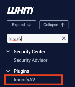

Once the site is taken offline for the report, you can start mitigation. You'll want to run a scan on the account on the server through WHM by searching ImunifyAV in the left-hand search bar:

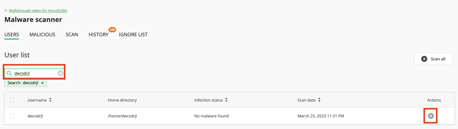

Search for the user's cPanel username in the Users tab. Then you can click the button to scan the account.

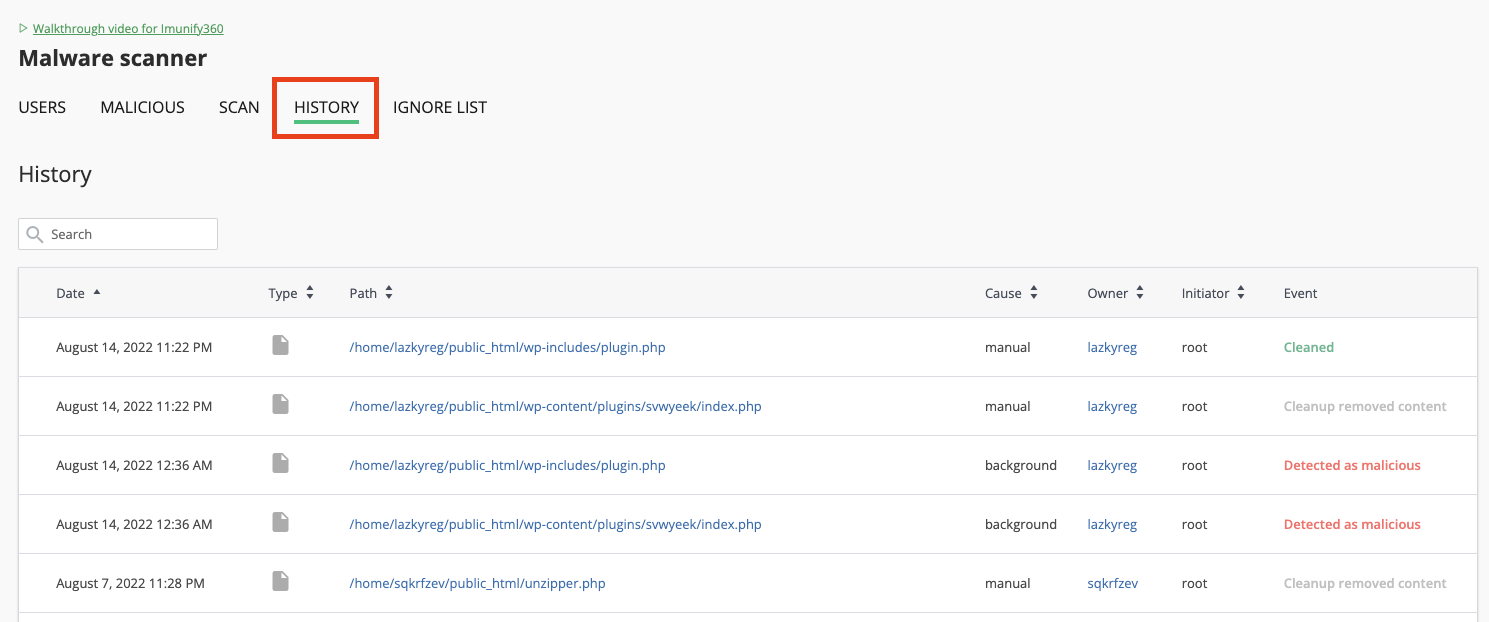

The scan will run through each file on the account and flag any potentially malicious content. You'll see any flagged content in the History tab.
Take a look through the history section to identify any pattern as to where the site is compromised.

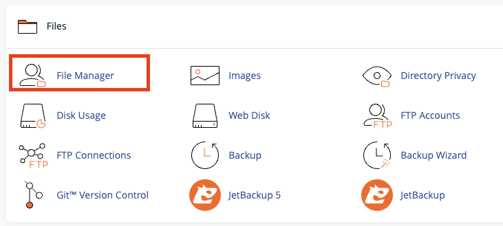

With the pattern identified, you can now remove the content. Within the account itself, navigate to the File Manager to remove the content.
Follow the file path listed in the Imunify Scan and delete the content. Make sure to delete it completely rather than send it to the trash.
