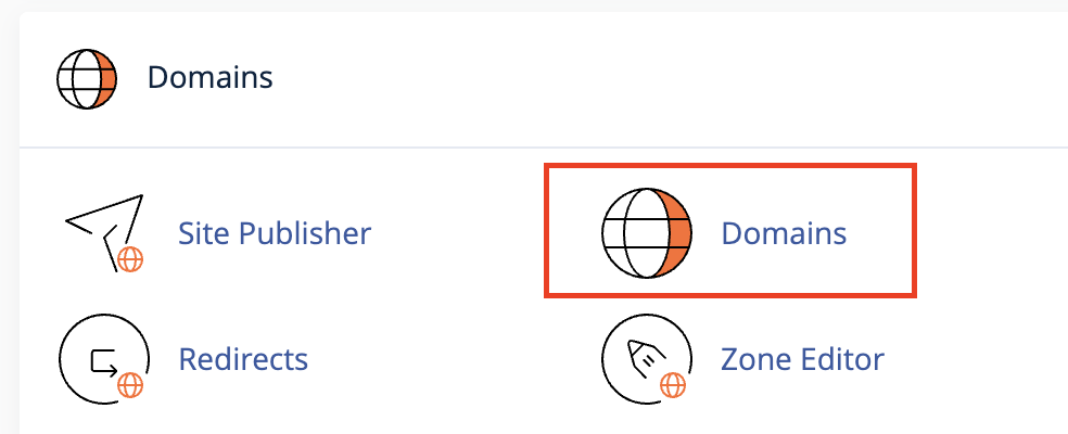

  1. From your cPanel dashboard, go to the Subdomains section.
  2. Create your wildcard subdomain by typing an asterisk (*) in the "Subdomain" field. Click create.

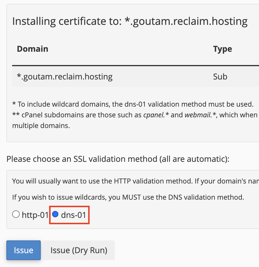

  4. Find your new wildcard subdomain and click + Issue.
  5. On the following page, be sure to select dns-01 as your validation method and click Issue.
