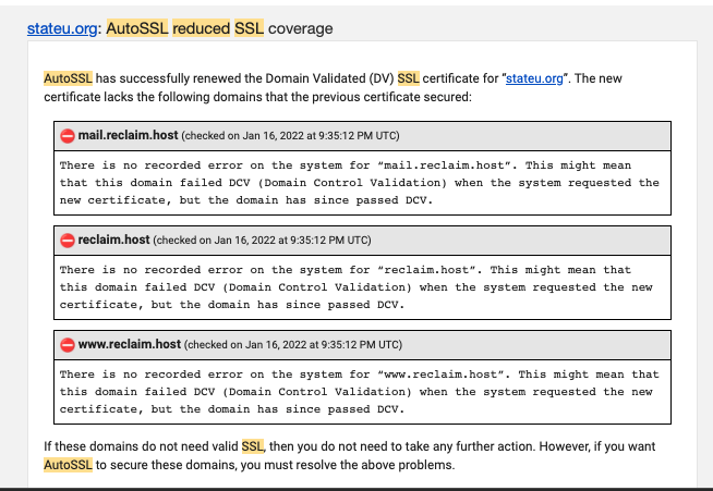

Have you received emails from cPanel lately that mention Potential reduced AutoSSL coverage on particular URLs?
They're likely for URLs like webmail.test.university.edu or cpanel.test.university.edu. That email may look like this:
This is due to how the DNS is set up for your particular URL.

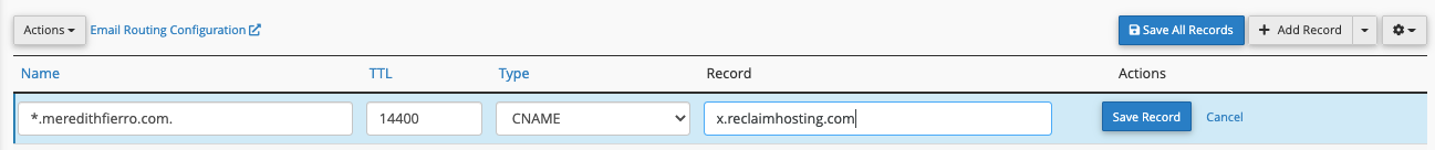

  • CNAME record: You can use a wildcard CNAME record to point the domain to the server. That record looks like this:
*Both of these records will point the domain to our server, but we recommend using the A record to point your domain to our server's IP
If you're receiving these errors from AutoSSL, it's likely you're using one of the DNS management options as listed above. That is because while you probably have the main URL pointed to the server using an A record, the subdomains like webmail.test.university.edu are not pointed to our server.
If that's the case, you can adjust your DNS settings wherever the domain's DNS management is handled. Once the domain or subdomain in question points to our server, then AutoSSL will be able to add an SSL certificate for it.
